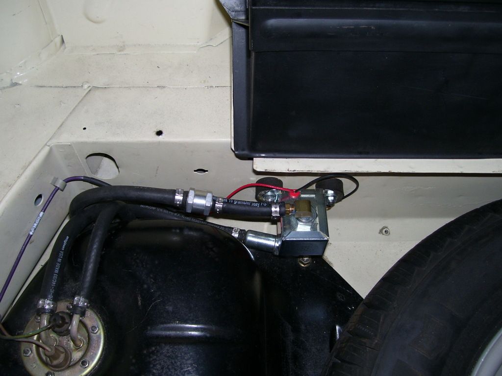

This is where my trunk mounted fuel pump is located. If you are going the "cube pump" route, the Facet 40-148 works great. I tried to use the 40-104 but was not getting enough fuel pressure or flow at upper RPM even though the pump specs. were correct for the car (PSI Min/Max = 1.5 - 4.0) (GPH=25). Changed to the 40-148 (PSI Min/Max = 2.0 - 4.5) (GPH=25) and my fuel starvation problems are gone (both pumps were new when installed). Midwest-Bayless has the Facet 40-148 cube pump for around $55.

That a filter on the bottom and a check valve on the top?

Yes to both questions (the filter was purchased from Facet and the check valve from Midwest-Bayless). Also, the rubber mounts are really needed to keep the fuel pump noise down.

I've got the other style pump I'm prepping for mine, do you have any problems drawing fuel through the existing top mount setup?

No problem at all, both of the Facet cube pumps I have used have a 24" dry lift.
