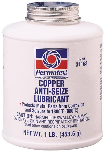

The lower alternator bolts get rusted in bad a lot of times. Use penetrating oil and time and you will get it out. The fact that you got it to turn any is better than some have done in a weeks time so you should be go to go is short order. Use aint-sie when you put it back together.

I have always liked
and then use
and then use
