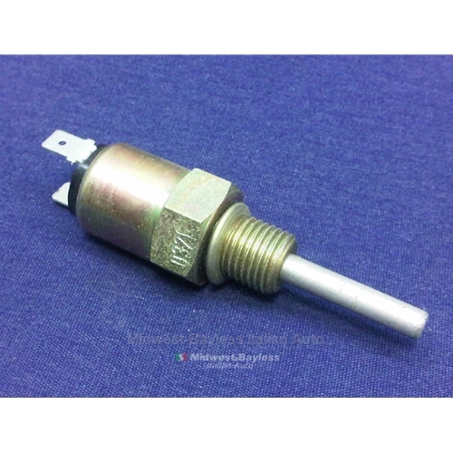

Hi, I'm trying to figure out where this switch is supposed to be located. I had a connector that went down the center console and wasn't connected to anything. The connector has a pair of light blue/white and white wires and comes from the fasten seat belts relay located in the passenger side of the car. And from the looks of it, it's supposed to be connected to this "back-up lights and 5th gear switch". Now, I found online that it's supposed to looks something like this:
Is this physically mounted to the transmission? I couldn't see anything dangling from under the car, but haven't gone down there yet.

Arthurk, that looks like the backup (reverse gear) switch on the transmission. It can only be accessed from below, and it should be pretty much the "most-rearward" thing on the transmission except for the output shaft. Without it, your backup lights won't work.

I just re-wired this a week ago. The wire colors for the backup switch are 2x green with a white stripe and 1x yellow.
