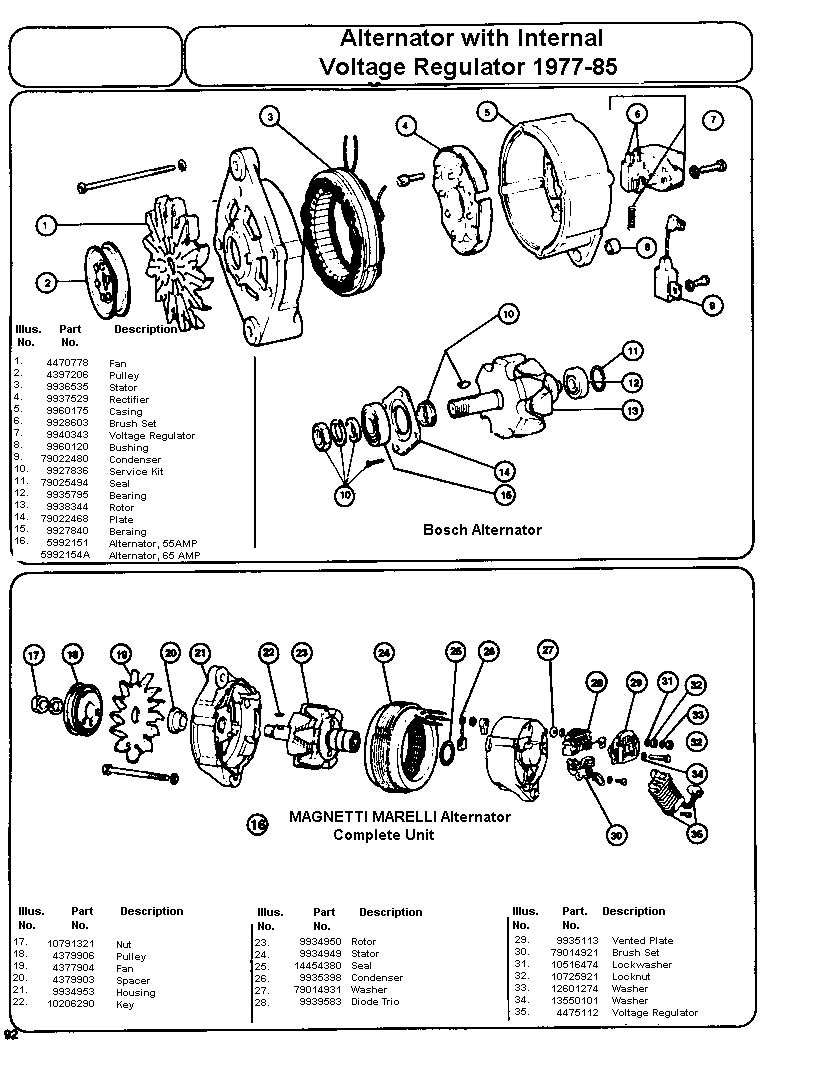

Thanks, already have one. Do you see all the parts that I have pictured in those diagrams? I don't .
What I really need is someone that has either has one apart or an alt off the car where they could take a picture of the pulleys and fan, that would be helpful.
